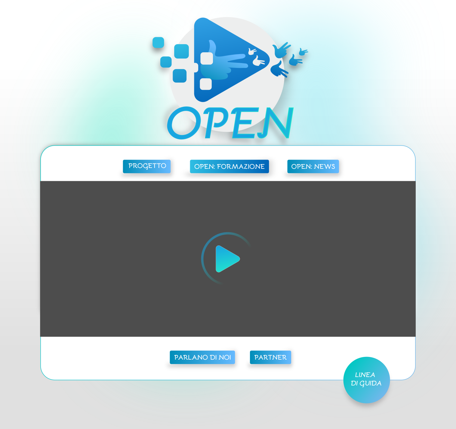

hi
i want to ask you for to know wwb17 will can adjust size of shape if screen will change (responsive)?
see example my design web:
see that shape rettangle around central , wwb17 will can shape responsive (adjust automatic like as example vector shape change size if screen will change (mobile, tablet)?

Post by wwonderfull »
Yes you can resize shapes or images in break points by adjusting its size. Usually you can scale the object in any size in BREAK POINTS of a page, there is an option to scale objects automatically in wwb options. But you have to know what you are doing along with what are the potential settings you need to do for it. You have only showed the desktop vision of what you want but we don't know what is your exact vision for the mobile version. If you can provide another design of the mobile view or a demo project that would have been much helpful.

sorry, maybe you are nor understand, i want to say that shape style same this:
Image so i wish convert in wwb17 and Output to SVG...
outlinea or border with gradiend+shadow+solid for shape+round?
can does will do?

manuel_songokuh wrote: Thu Mar 17, 2022 12:53 pm sorry, maybe you are nor understand, i want to say that shape style same this:
can does will do?
Please use google translate to write more grammatically. hard to grasp your writings.
Yes it is possible. You can do it if you can understand how to implement it. Pardons, but the thing you want to do only you know if you can understand how to do it. For us we can do a work around for the same thing you are wanting to do very simply. Hard to imagine what layout you exactly want as the final output.

I think the effect is your example is an image. it not an HTML effect.
