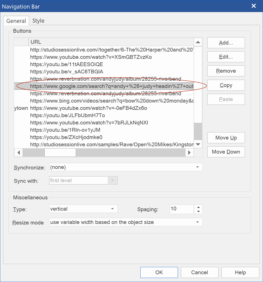

there is a navbar.
navbar has a url, "http://andyjudysing.com/track/2077936/h ... t-to-omaha"
that url works in any browser
the navbar generates
"https://www.google.com/search?q=andy+%2 ... OHoECA4QYg"
whny? what the heck is going on?

- Posts: 23898
Re: navbar strange
It looks like you have accidentally copied this URL to the properties.
if you need further assistance then please share the project file.

crownfield
- Posts: 71
- Joined: Mon Feb 04, 2019 1:04 am
Re: navbar strange
studiosessionlive.com/public_html/tfr/pablo/MusicTogether.wbs
if you mean by properties, did I copy it to the url for that menu choice, yes I did.
the url which works in the browser does not work in the navbar.
something causes the navbar to initiate a google search for god knows what.

- Posts: 23898
Re: navbar strange
The software does not randomly generate URLs, you have set the URL in the properties of the navbar yourself.
crownfield
- Posts: 71
Re: navbar strange
you are right.
the first five times I checked it and pasted i was not a google search.
I went to their web site, went to the specific page, and copied and pasted that url.
I actually reentered each 'word' in the link, thinking there might be a hidden character.
in any case, thanks.
