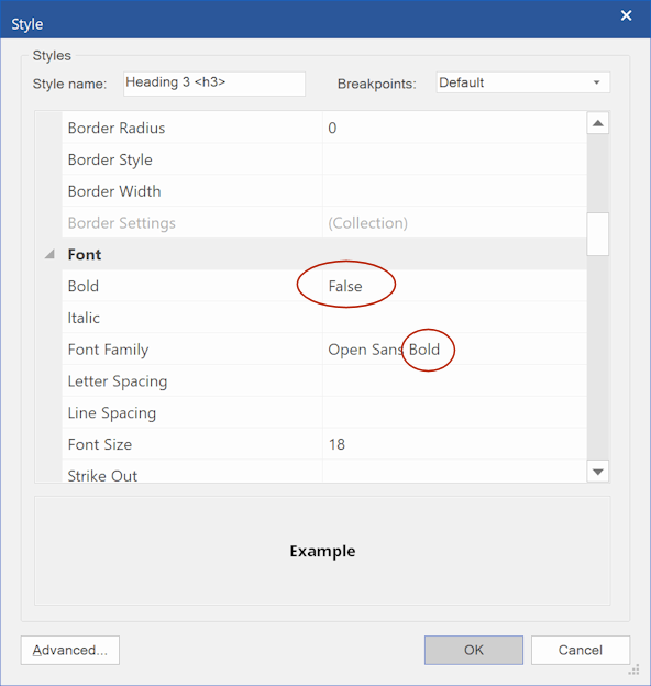

- Posts: 24883
Re: Google fonts not appear correctly on browser
There is a conflict in the style settings.
For example: in Heading (h3) the bold property is set to false (= 400), but the font itself is "Open Sans Bold" (= 700)
If the font name includes the font weight then the Bold property should be empty, because the font-weight is determined by the font name.
