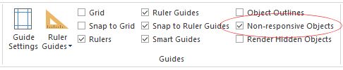

Is there a quick way to see which objects on my page are responsive?
Yes, you can use the keyboard combination Shift+Ctrl+R to outline all non-responsive objects on the page. The outline color is currently fixed to red.

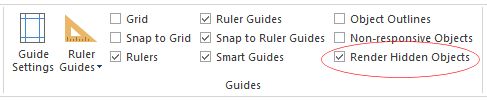

Tip: In WYSIWYG Web Builder 10.3.3 and newer you can make hidden objects visible with the option 'Render hidden objects', this makes it easier to troubleshoot layout problems.

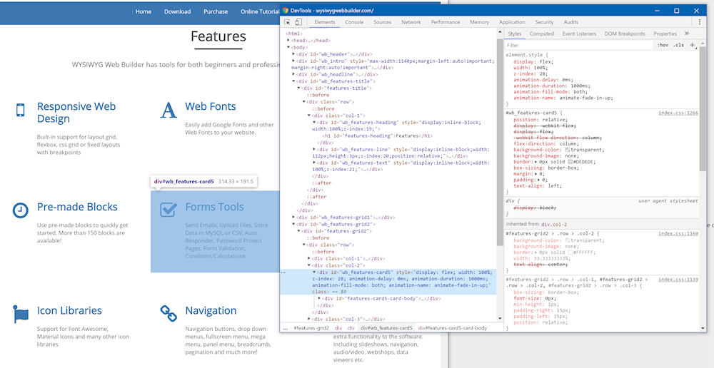

Also, the browser's debugger (F12) may be helpful to find objects outside the viewport. By selecting objects in the DOM tree, you can walk through objects and see the position on the page.

Non-responsive objects (View Menu)
Enable this option to outline objects that are not responsive. This may be helpful for Responsive Web Design, so you can either change the object's properties to make it responsive or use 'Clone and Hide' to create a new instance of the object.
Render hidden objects (View Menu)
This option may be useful to trace layout problems caused by hidden objects. Note that hidden objects cannot be edited., so you will first have to unhide the object (with the Object Manager) to make changes.
