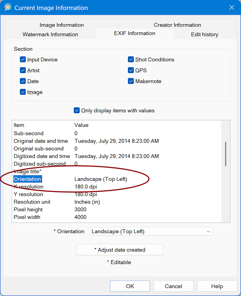

1. Please open the image in an image editor and remove the orientation EXIF data. It is currently set to 'landscape' this will cause the image to be rotated twice.
Also note that your images are way too large for a website. I recommend to optimize the images before adding them to the page.

As I wrote, I rotated it with the button in the top menue of wbb
If the image you are trying to use already has the wrong rotation then using the image rotate function will not correct this.You will need to correct this yourself externally first then bring into the software. This has be discussed previously in other posts.
BaconFries wrote: Mon Nov 25, 2024 8:58 am
However surely the image should insert to WB in the correct original orientation and allow proportionate resizing?
Please note that the software does not rotate the image(s) they are inserted "AS IS". This is due to how the photo was taken by the camera and the EXIF data contained within the image. So even if you rotate it in the program the EXIF data is read by the browser and displays it as is intended. For example if image (photo) was taken at Landscape and you rotate to Portrait in the program the browser will still return to Landscape due to the mentioned EXIF data in the image (photo).

Thank you. I did it with IrfanView and now the picture is shown properly!
