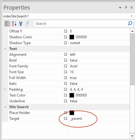

2. You can set the target of the link in the property inspector. Did you try _'self'?

Re: The SEARCH object
1) understand
2) Where can I set that?
- Posts: 25025
In the property inspector.Where can I set that?
In the "Results" selection drop down? There is no such option
Sorry, Can't find such a dialog...
The Search input field has the following tabs : General, Style, Box Shadow, Padding
Obviously, I should look elswehere.... where?
- Posts: 25025
See 'Property Inspector':
https://www.wysiwygwebbuilder.com/introduction.html
OK, Found it and the result is OK, But
