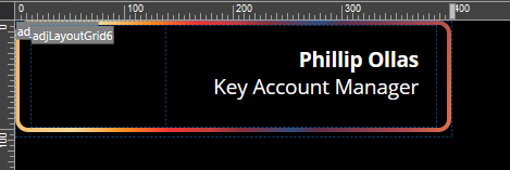

Hi friends,
I have a small issue, that I hope all the WWB can help :D
I tray to publish with a radius border inside the Layout Grid.
This is what I did:
This is how is see it before publish it:
And this is what I get:
Here are a small demo project: http://salvapiscinas.es/test.wbs
Thanks in advance,
M.

I could be wrong, but I'm not sure you can. To create the border as a gradient it is using css border-image to create itr and I don't believe border-radius works when border-image is used. It's a css thing and not a wb thing.
Posts: 6057
Re: Radius border issue
To carry on from crispy68 it may also be related to the browser.
Note: at this moment most browsers do not support a border radius in combination with gradient borders

@BaconFries are right. If a change to a "solid" frame, it works perfect.
