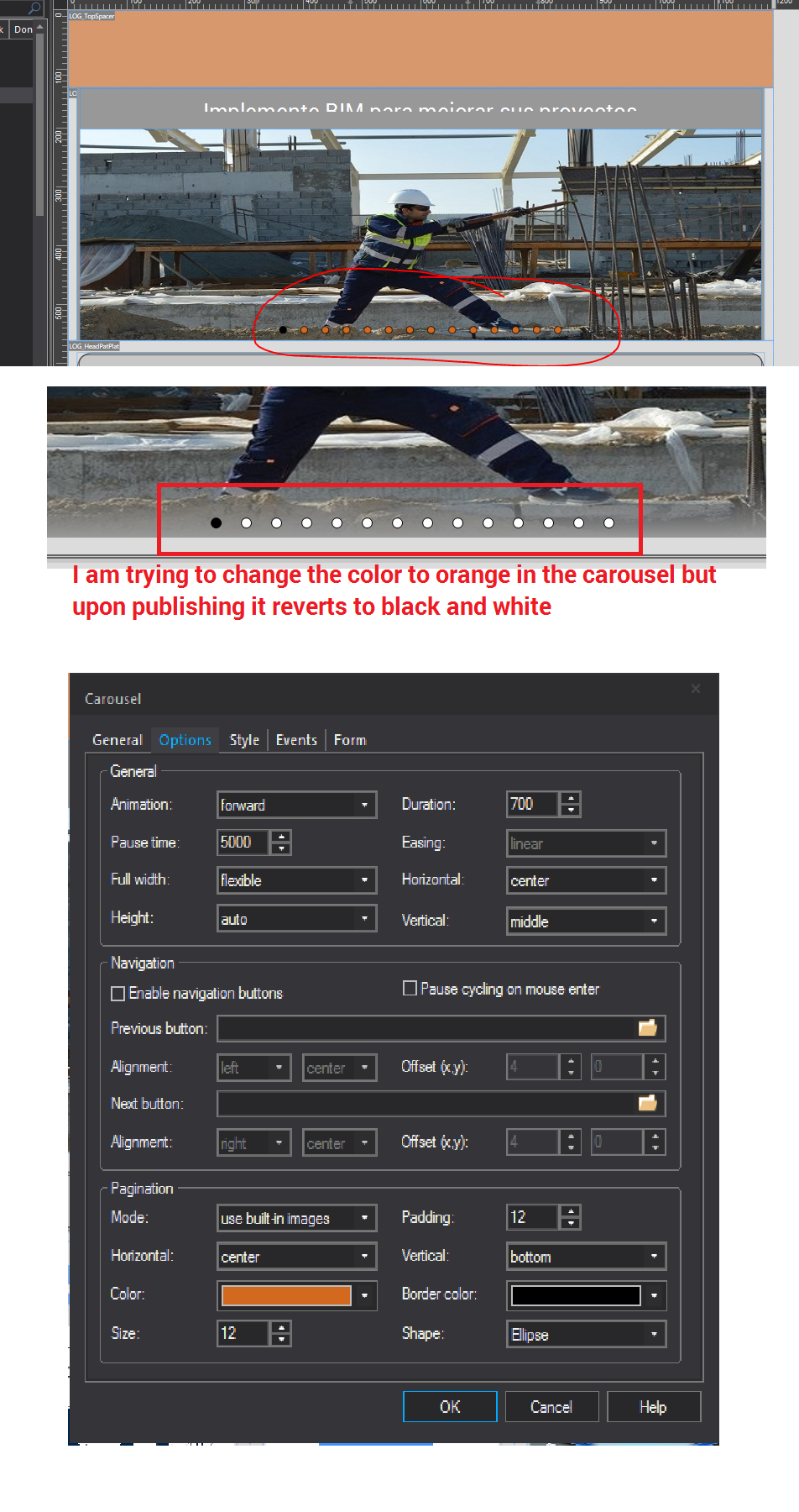

I seem to be experiencing the same issue, I placed a carousel in the index page where I want the pagination in an orange color and it looks correct in the design page, but when I preview the page or publish the page it goes back to black and white
https://www.bimcostarica.com/
Any idea what is the problem?
Regards,
Jose
Regards,
Jose

Re: Carousel pagination black and white circles
Hello,
I started deleting parts of the site until it got fixed, the issue seems to be related to a copy of the same carousel I made to a diferent page inside a Layout grid, a test I made several weeks ago and had not deleted it.
Question remains in my mind. The carousels were in different pages of the same site, they did share images as I copied one to create the other, copy from the index page to that test page. I would not have expected this behaviour as the two carousels were in different pages, is this normal?
If the Carousels have the same ID then they will have the same images.
The filename of the image is based on the ID of the object.
Thanks for the clarification, indeed they both had the same ID and changing the ID did correct the issue
