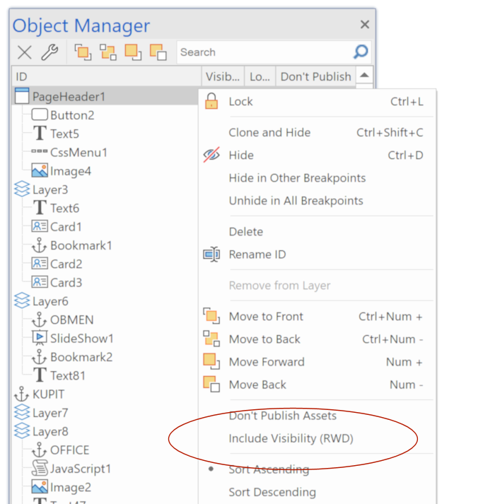

In the main version, I have the header layer installed, which is in fix mode. How to hide it, it does not allow you to continue working with it
- Posts: 24874
Re: question about the mobile version
You can use the Object Manager to unhide objects so you can modify the properties.
This option is enabled
- Posts: 24874
Not for the header

- Posts: 24874
The option is still OFF for the header. It must be ON (checked)
Please read the FAQ to understand what this option does.
Well, that's settled. But the page still doesn't turn. I am hiding a block with parallax in the main version.
