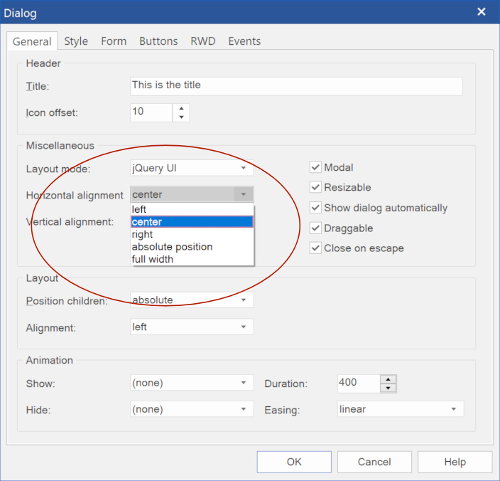

- Posts: 24188
Re: Adding Popup Window to links
In the properties, you can use the 'alignment' options to control where the dialog will be displayed:

Excellent video, the only thing he is not showing is how to hide the dialog box when the page opens but i figured that out.
I used to have a photographic memory but i ran out of film !!!
- Posts: 24188
You can set the initial state of the dialog in the properties: Show dialog automatically.
