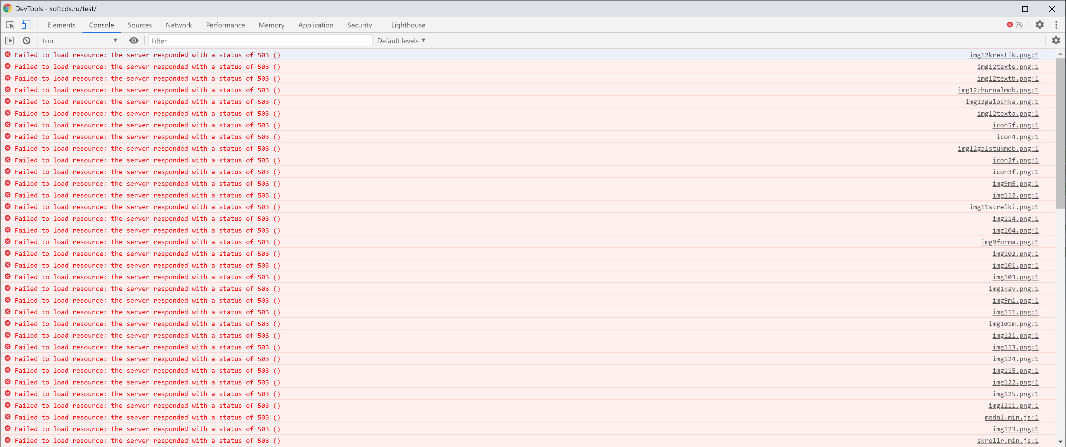

I did some more tests and I was now able to reproduce the problem.
This is definitely a server related issue. See the error log of the browser:
