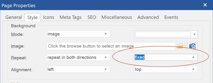

Set your layout grids to a max width (by using the - sign in front of your size, such as -1140) and add your content.
- Posts: 24889
Re: picture background with scrolling content
You can set the background image to 'fixed'

- Posts: 24889
When you use a master page, then the background of the master page will be used.
If you do not want to use the master page background then set it to 'transparent', in that case you can set the background for each page individually.
