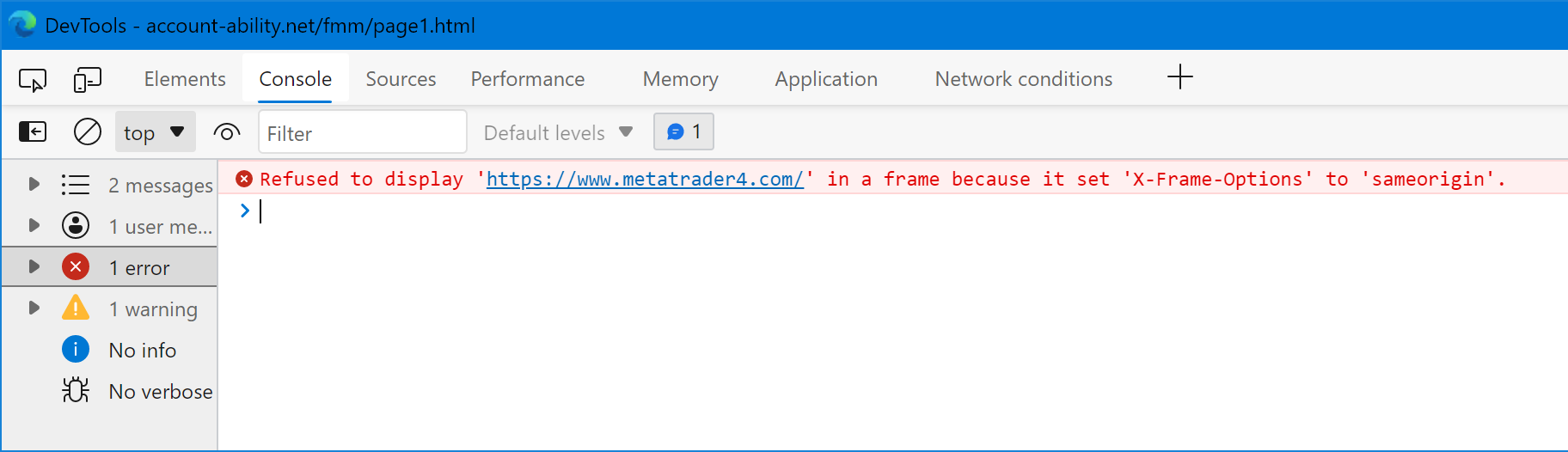

This is not a problem of the inline frame, this is a restriction of the page.
See the browser error console:

Re: In-Line Frame Problems
Is there a workaround or another method to display another URL within a project html?
- Posts: 24891
There is no work around, as far as I know. This is a security restriction. An inline frame is a standard HTML feature, so this is unrelated to WWB.
