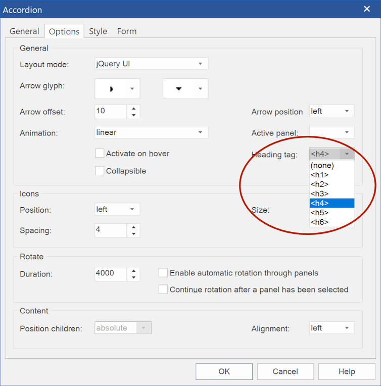

on this page I have an accordian and there is a shadow under the text. Where do I remove the shadow from. I have looked in the style and cant find anything on where to turn on/off

It looks like you have added shadow for heading via the Style Manager (h4)

Thanks Pablo,
That fixed it.
This is enabled by default on the H4 tags as I have not changed anything within the style manager for WWB17

Heading styles in the Style Manager apply to all headings on the page. This has not changed in version 17
What has changed is the ability to configure which heading is used by the Accordion, previously this was hard-coded.
