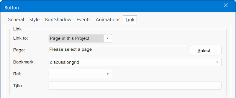

This is the button link in test1

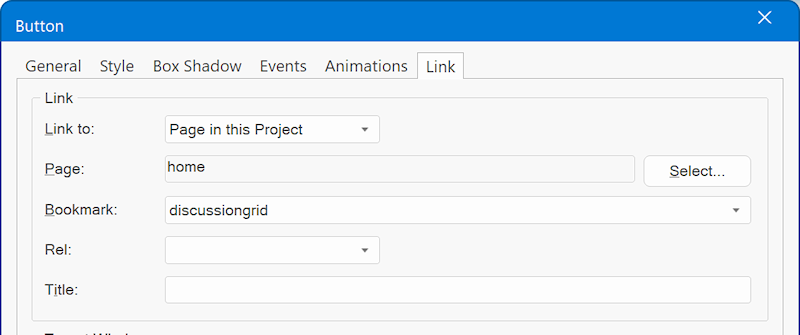

This is the same button link in test2

This is not a bug.
The way you have currently set up the bookmarks, they are referring to another page (even though its the current page).
This makes the bookmarks only valid within the context of the project, because the bookmark is a reference to a page which does not exist in the new project.
Not correct:
Correct:
You can make it work by removing the page reference from the bookmark.
To do this, hold the SHIFT key and press 'Select'
For new bookmarks on the same page, do not select a page, but directly select the bookmark from the list.
