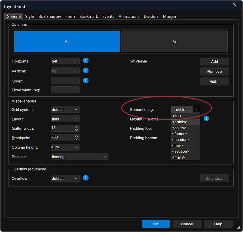

<article> is a container tag. So, you will need to set the 'Semantic tag' property of the container.
