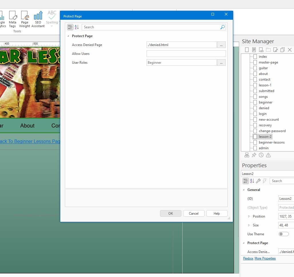

If I type in the user names in the "allow users" it will work but not just by choosing user roles.

I'm a novice which is why I love this software. What do you need from me. I'll gladly post it. Thank you for your help.
[imghttps://www.videoguitarlessons.online/images/VID.jpg][/img]

When I have any of the user roles selected it won't let me in. The demo site is live right now. I have you as an admin. Username is pablo and password is pablo123. I have administrator checked for user roles right now. I can't get in with my sign in or yours. When I uncheck the user roles I can with any. See if it works for you. I've tried it on other machines too. https://www.videoguitarlessons.online/index.html
Posts: 23881
Re: Protected page doesn't work when user roles checked
It looks like you are using a CSV database?
This option does not support user roles.
This is from the help:
Important: User roles are only available when the database type is set to MYSQL, CSV files do not support user roles.

Thank you. I guess I need to learn about My SQL. Have a great day.
Posts: 23881
Alternatively, you can also use the embedded database option.
https://www.wysiwygwebbuilder.com/login_embedded_db.html
