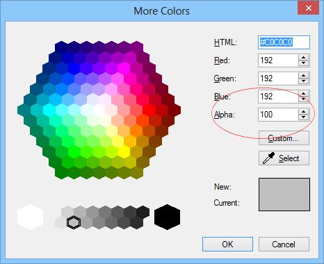

Apologies to Chapy & you Pablo for hijacking this thread, is there anyway to be able to enter the value in the colour slider as sometimes it is very hard to get the right value using a mouse.
Posts: 23481
Re: Transparancy for drop down Responsive menu
Select 'More colors' to set the exact values.

The problem is with the PAID Extension called:
Responsive Drop Down Menu.
It does not have an Alpha slider in the color graphic that Pablo posted.
Has there been an update to that extension that has added the Alpha Slider??
If so, how can I download and install?
Chap
Posts: 23481
I'm sorry, this feature is not available in the Responsive Drop Down Menu.
